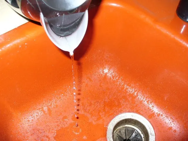

A good mod for almost any kettle is to fashion a small cotter pin, or a piece of wire clipped to the spout. It will allow a very precise pour, as it encourages the trickle to flow off a small point.
Great idea, any chance of a sketch?
That's a Bonavita gooseneck kettle. First, I squished the spout with a pliers, but it didn't help much. So I found some wire, about the thickness of a paperclip and cut it 3/4" of an inch, folded it back on itself and slid it on. Works very well.
The initial attempt was with a cotter pin on a wider-spouted, "normal" electric kettle, which also worked well.

Pardon the old ugly sink, before the remodel...
Oh boy that sink! That kettle works great Ive had something similar to it before.
